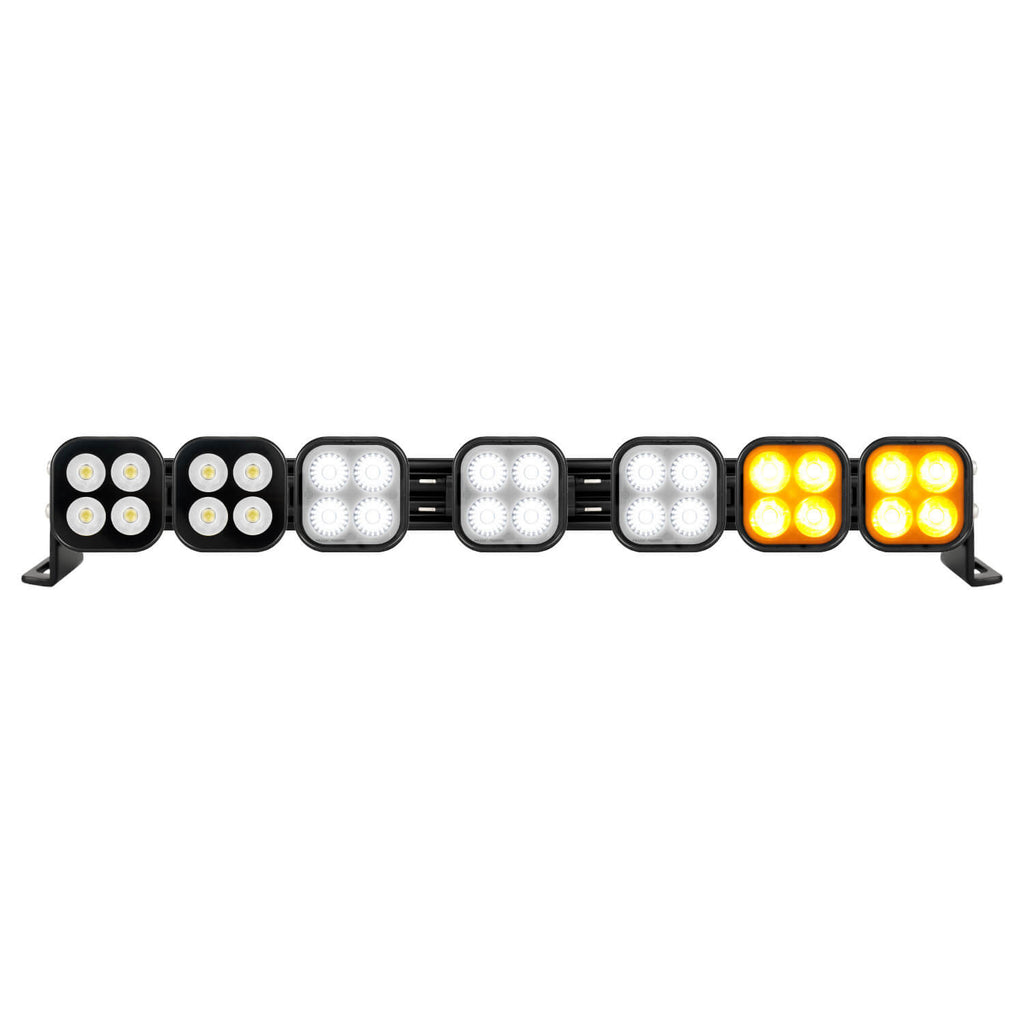

I have the VisionX 20” Unite light bar.
I pieced it together with 4 Amber floods on either side. Spot white in very center and white floods either side of center.
