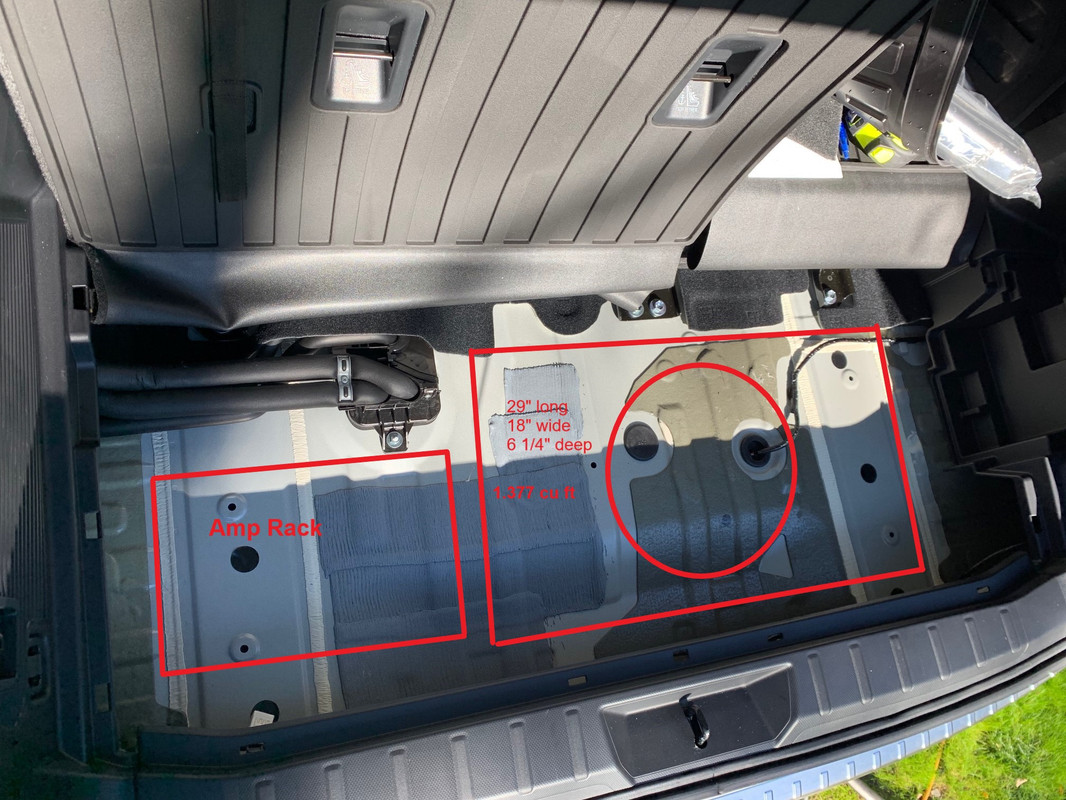

The biggest part of the project is to build a custom subwoofer box in the rear storage compartment. Actually, I would remove the storage tray. That tray is barely 11" front to back, and at the most, 5.5" tall. But the deepest part of the tray slopes inward, so there's probably a bit less room than that. If I use 3/4" MDF to build the box, that very little depth for a shallow sub and a not very big one at that. Furthermore the volume of the box would be minuscule.
So I pulled the tray off today and took some measurements. There's a LOT more room without the tray! It's about 29" wide before the pipe-like obstructions, and 18"+ front to back. Depth is 6 1/4".
I figure I can build a nice box to fit the space. A 29 x 18 x 6 1/4" box would have about 1.377 cu ft internally. That's more than enough for the typical shallow mount 12" subwoofer driver. As for the driver itself, there are a TON to choose from. JL Audio is the most well know and definitely quality but the best shallow mount they make is over $600. That's a bit pricey. Kenwood makes a nice 12" sub driver: https://www.crutchfield.com/p_113XW1200/Kenwood-Excelon-KFC-XW1200F.html
There are other shallow mount subs like this: https://www.woofersetc.com/c-23-subwoofers/c-120-shallow-mount-subwoofers/sd-3-12-d4-sundown-audio-12-500w-rms-dual-4-ohm-sd-series-subwoofer.html
The floor of the storage compartment already has some glued on pads of some sort. I figure they're there to dampen vibrations. I plan on using a Dynamat clone and lining the compartment, leaving cutouts for where the rubber grommets are on the floor of the compartment.
Also the compartment floor is not perfectly flat. It slopes downward at the very rearmost part of the compartment. To keep the sub box level and to help with isolation so I don't get the typical rice rocket boom buzz, I'll use some sorbothane isolation pads cut down to the appropriate size.
Here's a quick mockup sketch:
The plan is to have all of this sitting under the storage compartment cover. As for the cover itself, it appears to be made of a very stiff material. I'm not sure if it's plastic or some other material. It might e a good idea to remove the carpet-like material and drill some holes to allow the sub to vent. I can recover the lid with a more friendly acoustic material.

I don't think the biggest part of the project will be to build a custom subwoofer box in the rear storage compartment. You don't really even need to do that, you can simply use an external subwoofer enclosure. I did that for years on my Forester. I would simply remove it whenever I needed to load something large. Even if you want to build the custom box, that's still not even close to the biggest challenge.
The biggest challenge you face is retrofitting the existing factory head unit to external aftermarket amplifiers. This is the big challenge to everyone these days now that factory infotainment systems are so highly integrated that they can no longer be swapped out with an aftermarket head unit. Only until you conquer that, does the rest become doable.
You'll first need to dig into the factory wiring to see if it's possible to capture preamp outputs. Since the Rockford Fosgate option exists, this may be a possibility. If it is possible, then you probably only need to add external amps for the speakers and subwoofer. If not, then you'll have to go with the existing speaker-level outputs and feed them into a special DSP like the FiX-86 you mentioned to eliminate the factory system's equalization, crossover filtering, and time alignments. Only then can you get a decent flat signal for your external amps. Then you'll need to add your own equalization because you won't be satisfied with a totally flat output, no one ever is. You can also use the FiX-86 to add your own equalization, which is a great feature, but this will require a laptop running TüN Software via USB which is not great for on the fly adjustments.
Then you're going to need to find places to mount all the massive electronics, provide very heavy gauge power wiring directly from the battery to both amplifiers, and deal with all the interconnects. Then you're ready to mount the new speakers. I've done this many times, and it's a major project. It's going to cost you well over $1,000 to do it right, and it'll require many day's if not a week's worth of hard work tearing into the Ascent.
I'm not trying to discourage you, in fact, I'd love to see someone do the groundwork and prove it can be successfully done on an Ascent. But if you do undertake it, it'll be a major time and $$$$ commitment that you'll need to plan carefully, well in advance to get the results you want.
You could simply go with the Rockford Fosgate option. That would give you a decent primary amp. You could then choose your own speakers. The big challenge would still be to add a subwoofer amp and speaker since there is no provision for that, and any audio upgrade without a subwoofer is not going to be great.
So this is a considerable challenge and I applaud you for having the intestinal fortitude to even consider it. This time around I wimped out and simply went with the Harman Kardon upgrade which is decent but falls considerably short of being a true audiophile worthy system, especially with no equalizer. I'll have to live with that, but at least I didn't have to once again endure the pain of rigging in another aftermarket system.
Best of luck with this. Please keep us updated, your experiences should prove very valuable to many here.

Thanks all for the replies. Someone here posted up how to get to the head unit and behind the passenger side dash. I'm hoping to run the wiring on the floor along the threshold from front to back.
The amp is going to sit in the rear compartment on the floor next to the sub.
I do wonder if I need one of those big capacitors since the stock wiring and amperage may be inadequate.
Yes, it's going to be a lot of work. I'm using this vehicle to practice on before I upgrade the system in my truck. That one is going to be a monster project lol.
